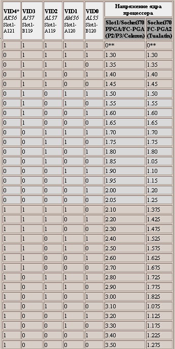

As to a power then too all is simple enough. For his installation legs VID0, VID1, VID2, VID3 and VID4 (last, generally, is marked as Vss-"ground" that there was no opportunity to expose a voltage above 2.05V, however, as a rule, in the majority of PPGA-motherboards he on her "does not sit") respond. Proceeding from a combination of signals ("0" - the ground or "1" - it is not connected) on these legs{foots} the power unit of the processor established on a motherboard exposes the necessary voltage.
Table1. The combined table of voltage for processors Slot1/Socket370.
* - for FCPGA2 it VID25mV
** - in case of units on all "VID-ah" voltage is not exposed in general (it is regarded as absence of the processor) - 0 Volt.
First motherboards Slot1/PPGA (from submission Intel that she will not make Slot1/Socket370-processors with voltage Vcc less 1.8V) have been equipped Power supply CPU, not supporting installation of processors with a power is lower 1.8V (i.e. at installation of the processor with smaller Vcc, the combination on its legs VID0-VID4 was interpreted as 1/1/1/1/1, i.e. in result it was exposed "0"). Therefore, to bypass such problem it is necessary to establish "compulsorily" Vcc> =1.8V. In case of an opportunity of adjustment of a voltage (on an adapter / motherboard) it is necessary to expose simply the necessary combination crosspieces (see table.1). If such opportunity no, then it is necessary to make it "manually". For example, if at you the processor with a power 1.7V, means a configuration of VID's - 0/0/1/1/1 then, having closed VID1 " on the ground " (or even on the same, already earthed in such processor, VID4 or VID3), we we shall receive a combination 0/0/1/0/1 that corresponds 1.8V which power supply CPU "knows" and will correctly expose. Certainly, in that case the processor will work on the overestimated voltage, however, first, many (Vcc) all the same specially raise it (" for overclocking "), and, second, (the greater heating) always it is possible to overcome it with the help simply a better cooler.

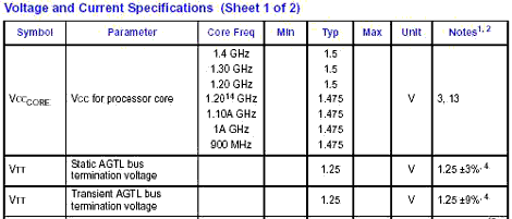

"Main thing" - the "new" bus. Already only absolute similarity of names casts some doubts - like, the same, only without plus. Which, probably, designated those 0.25V on which the level of signals has gone down - in AGTL + he is equal 1.5V, and in AGTL - 1.25V. Accordingly, from " official documents " it turns out, that: "processors Tualatin cannot correctly work on old parent motherboards which give out a voltage on 20 % above necessary (as the level of a voltage submitted on inputs of the processor, should have disorder no more ±9%)". And, really, if to address to "primary sources" (the documentation on Taulatin from a site intel.com) it is possible to read:
To item 4 it is in black and white written, what yes, really, 1.25V +-9 % (and to develop - so, in general, " with a sight " on +-3 %) and it can't be helped. However somehow empty columns Min and Max are suspiciously looked, and such "basic" difference goes only as the note (and it read - only the recommendation). Very much looks like the variant "updated" by experts in marketing.

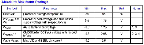

And, really, all clears up if to esteem page earlier:
Precisely and clearly (without any empty columns:), a maximum - 1.75V. such " double standards ".:) From here the first conclusion - Vtt=1.5V (i.e. the level of signals, such as in old non Tualatin's motherboards) for Tualatin is completely safe, as is essentially below possible maximal value (and, means, it can be overclocked and overclocked still:).

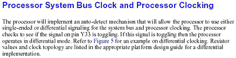

Other "statement" - a "new" way of the synchronization, "new" signal BCLK# (inverted BCLK). In AGTL + "one" is used for synchronization only BCLK (c by amplitude 2.5V), and the "new" couple from opposite on polarity BCLK/BCLK# (+1.25V and-1.25V) - so-called differential synchronization here has appeared. As - for more stable job such approach foggy speaks high frequencies. However all in the same primary sources is in black and white written:
I.e. the processor itself determines, what way of synchronization to use proceeding from presence of signal BCLK# on leg Y33. If he (BCLK#) there is present, then the processor is switched in a mode of differential synchronization, if no (and there - only analog basic voltage +1.25V) it is switched in "usual", old (single-ended) a mode with "one" strobing pulse. Accordingly, the processor inserted into system, "not knowing" differential clocking, will simply be switched for a "usual" way of synchronization (since supports both kinds).
Other signals (types / kinds) at AGTL the same, as at AGTL + therefore on it the subject of the "new" trunk can be closed.

Concerning "more thin" technology, and, accordingly, and lower voltage of a nucleus. In Tualutin, for an opportunity to expose a voltage to within 0.025V has been involved already becoming in PPGA/FCPGA unnecessary VID4 (since he was used only at the task of a voltage above 2.05V, and it already, naturally, has ceased to be actual). At his installation (VID4) in "1" to " standard (i.e. as at "old" PPGA/FCPGA-processors, i.e. VRM8.4) it it is added 0.025V. Therefore this signal (leg) and have named - "VID25mV" (see table 1).
In case VID4 (VID25mV) it is equal "0" such combination differs nothing from "old" (VRM8.4). Accordingly, simply compulsorily having short-circuited VID25mV " on the ground " (for that "old" power supply CPU casually has not exposed proceeding from unit on VID4 a huge voltage, so, for example, at Tualatin with Vcc=1.475V, a combination = 1/1/1/0/0, that corresponds 2.3V for "old" VRM8.4), we shall safely solve this problem, i.e. we shall receive a "correct" voltage with a rounding off up to 0.5V in the smaller party. And at desire, besides, with "accuracy" in 0.5V, always it is possible to expose the necessary voltage "manually".

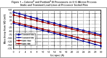

In the end - about a popular belief - "basic" difference VRM8.5 which "is able" to lower a power with growth of a current of consumption. This ridiculous conclusion has been made from appeared in the documentation on VRM8.5 tables:
Actually, certainly, all is banal - the schedule represents only "standardization" of that as so always is present at any power supply - decrease in a target voltage at increase of a current of loading. Speaking is exaggerated, he demands, that the target voltage changed no more, than on ~0.15V in all a range of change of a current of consumption of the processor (in 8.4 were precisely same "frameworks", exact values on all range of change of a current only have not been painted).
